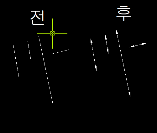

선 양끝에 화살표를 그려주는 리습입니다만
한번에 1개씩만 선택이됩니다. 이걸 한번에 여러개 선택해서 바꾸고 싶은데 어떻게 수정해야하나요?

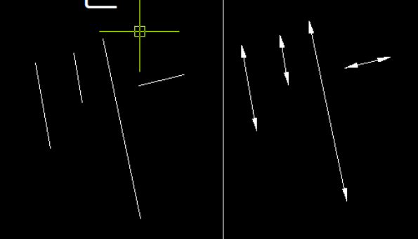

      (defun c:ahl (/ p1 p2 p3 p4 a10 a1 a2 s1 s2 lin pickpt linname lindata ang1)
      (setq cosmode (getvar “OSMODE”))
      (setvar “OSMODE” 0)
      (setq ss (ssget ‘((0 . “LINE”))))
      (if (/= ss nil)
      (progn
      (if (= (getvar “USERR1”) 0.0) (setvar “USERR1” 3.0))
      (setq s1 (getvar “USERR1”))
      (setq mess (strcat “nArrow Size = “))
      (setq s2 (getreal mess))
      (if (= s2 nil) (setq s2 s1) (setvar “USERR1” S2))
      (repeat (setq n (sslength ss))
      (setq ent (ssname ss (setq n (1- n))))
      (setq lindata (entget ent))
      (setq p1 (cdr (assoc 10 lindata)))
      (setq p2 (cdr (assoc 11 lindata)))
      (setq ang (angle p1 p2)
      ang1 (* (/ ang pi) 180)
      a10 (* (/ 10.0 180) pi)
      a1 (+ (- ang a10) pi)
      a2 (+ (+ ang a10) pi)
      (setq 1ang (angle p2 p1)
      1ang1 (* (/ 1ang pi) 180)
      1a10 (* (/ 10.0 180) pi)
      1a1 (+ (- 1ang 1a10) pi)
      1a2 (+ (+ 1ang 1a10) pi)
      (setq p3 (polar p2 a1 s2)
      p4 (polar p2 a2 s2)
      (setq p13 (polar p1 1a1 s2)
      p14 (polar p1 1a2 s2)
      (command “SOLID” p2 p3 p4 p3 “”)
      (command “SOLID” p1 p13 p14 p13 “”)
      (setvar “OSMODE” cosmode)
